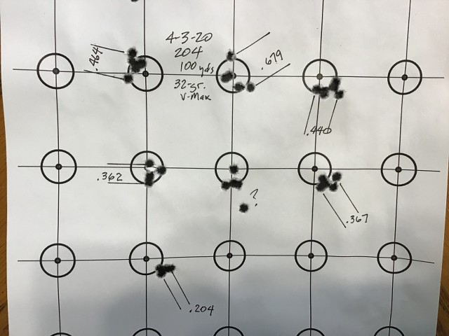

Ha! April Fools, I knew it! So I went shooting today, instead. No more testing, just dancing with who brung us. Rather breezey. Finally got a good group and then the wind blew my target frame over. Time to call it a day. Got a bunch of new brass to neck-size. All 5-shot groups, of course.

Hello,this will be my 1st post on this GREAT site,Gun is a 6br,remington action,28 krieger barrel,mcmillian stock,action trued, etc,chronograph was just a caldwell in a box using light bar,so not 100% sure on accuracy readings for fps?what charge weight would you go with?I am new to shooting free recoil so I'm trying my best..lol..reason I say this is because the 1st shot of each group was always high left?idk why?thank you for opinions and feedback :D

Try 30.3 and now test seating. Start at touch and then seat deeper in case(“jump”) by 0.003” at a time. Keep seating until you see groups shrink for one/two consecutive seating depths. Post results. Only need 3-4 shot groups for this to get a ball park

So kinda ignore my chrono readings?sd,es,? And go with 30.3,ok.when should I stop going back? -.030? And yes I plan to shoot friday and will post results weather permitting Thanks

You stop when groups tighten up to be what you want. You should see bad groups to ok groups to excellent. Should see two/3 groups back to back that shoot well

Well,drove out to cabin this am to do some testing?and idk?was hoping for better groups? -.021 and -.024 look ok?but my es is way to wide?and my "sighter group" was just a random measurement at -.038..and 3 shots outta cold clean bore shot the best?wind is not a factor,but between me and the scattered sprinkles of rain..idk?opinions welcome, Thanks

Take a look at the attached from Berger. VLD’s have a sweet spot of a band that is .030 to .040 wide and is located anywhere between jamming the bullet into the lands and .150 jump off the lands. The attached shows how to test to see where that sweet spot is.
It’s amazing that your sighters were the best group but you may have stumbled on the sweet spot with that particular seating depth. Quick question, why did you choose the seating depth of .038 for your sighters?
Red Dawg,thanks for the pdf,I have read that sometime back,I loaded all my rounds last night and quit when I was at -.030..I had 3 rounds leftover,sometimes I fill a couple xtra with powder when loading,I'm using a wilson microseater die,when I was done with the -.030 I turned in the die to shoot for a -.040 just for the heck of it and after measuremen's it was -.038...I figured they are then gonna be the sighter fouling load..after I shot all my test loads,it started raining again,so I went in cabin and cleaned gun and loaded some -.038 and -.021 and -.024, then between the rain I shot those groups, the -.038 shot ok?not like first group,the -.021 was 1 ragged hole, the .-024 was ok also,and then it started pouring rain...so I was done, that target I left in woods..lol .basically I need to practice my free recoil shooting more...then I'm gonna test more rounds again and yes when I shot that sighter group I thought wow?maybe I got lucky?well not after trying to duplicate it...my rounds are consistent in assembly,my shooting is not..thanks Red Dawg

It is easy to make a snap judgement, but at the same time, the first string of targets do tell you something worth listening to.
A full repeat of the series is worth doing. I am NOT a believer in the ladder/OCW theories - they have too many statistical holes in their theories, and I have shot too many groups to believe in that voo-doo.
Shoot groups a few times, it is easy for a load to produce a great group once in a while, but not be a great load.
When working up loads, I usually shoot the ones that look good TWICE the next time, because it is unlikely that you can have three good flukes in a row.
