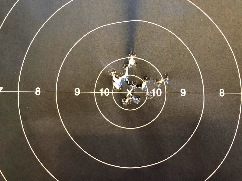

Any help or suggestions would be much appreciated. I'm pretty new to reloading and have been struggling to find a load for this rifle. Thanks
