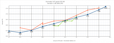

Proponents of a single shot chrono ladder seem to have fallen out of favor due to the insufficient statistics, but wondering if anyone has tried this using a "valid" number of shots to find anything informative? Im trying to stay open minded.
How about several single shot ladders. It's easy enough to rule out the extremes and bad areas and use fewer rounds with each string. Take your time, reload and shoot on different days and the sweet spot will be obvious.
