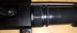

And right off the bat it looked alright ..until I messed with he handguard aaannnd yeah not supposed to do that ,
figured it was just the handguard loose. Evey BCA upper I've disassembled and been over torqued to the point it makes no sense so I had big doubts this would be any different but decided to check any way and surprise surprise... The barrel nut is barely much more then hand tight ! And guess who dint order a vice block and what not because they went thinking they would have to do barrel work just yet ....yep this guy

So clamped her on in the vice and torqued it in down some

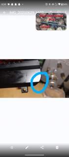

As you see this the pin hole on the rear that barley doesn't flush up which for this combo isn't uncommon apparently so needs a little work with a Dremel. And this is what seems to be the common deal...dose it make it right ? No but hay.
Also warning I'm not a gunsmith consultant a gunsmith before doing something like this.
So actually ended up grinding all around but right here really end up being all I really needed to hit
And using a light behind the upper while trying to fit it really helped with seeing were to grind
So just makes it off took my time and about 15 min later boom

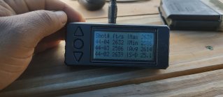

Honestly didn't expect much with factory ammo but had five round left so decided to get some velocity data, strapped on my magneto adjusted my set up a little and next group was a lot better, still a bit of a tired but better then what I see at the range come deer season lol !

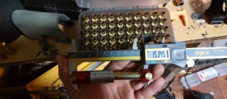

So as far as reloading I didnt get super crazy , again 6.5 creed is supposed to just work if you do a few things right so , new starline brass , (which btw was all under spec, honestly I fell like I could have just gave it a quick chamfer and debur primed and loaded them but I full length sized and tried to trim it all )and Hornady 140gr ELDM's which from my understanding are THE bullet for the creed

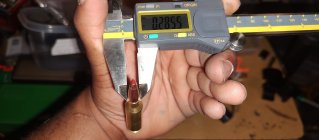

Coal/CBTO ? Loaded them to fit in my mag nice and easy but as long as possible and tested to make sure they didn't stick in the rifling
Also since this heffier does have a good bit of motion going during firing and these bullets are pretty slick decided to give them all just a kiss of a crimp to keep them in place. Tired measuring it but egh not sure how reliable it is

No clue what happened with that high left one . Did have one really low velocity
Really wanted to get up to at least 2600fps so decided to just go ahead and jump a half grain up to 42.0 and honestly, I'm gonna call that my max with this power , was definitely getting compression and personally I don't like compression
