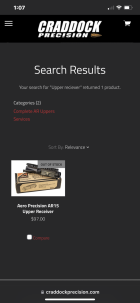

Aero precision is what Compass Lake Engineering uses, or used to use . I believe it’s also what Craddock precision uses. That’s the 2 top AR upper builders in the country, that I can think of. You can spend more but that doesn’t mean it will perform any differently. Looks like Craddock still sells them. Currently out of stock. Spend the money saved on a good barrel.1688EAA3-E3BB-46E3-8C4E-76B2BFDF7F02.png
