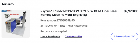

This is the model and options that I purchased:
