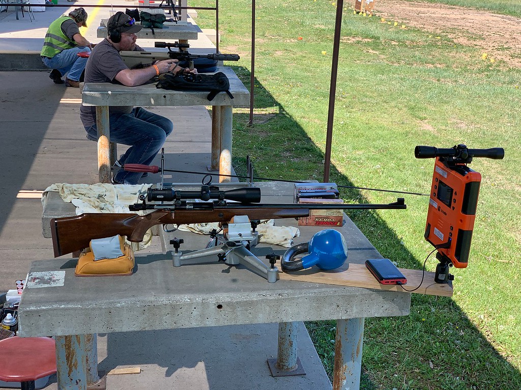

Paul, don’t let the people badmouthing the unit fool you. It’s actually really simple and easy to use. It honestly baffles me why people have so much trouble. Everyone else has already done the work on figuring it out over the years. You really just need to know where to set the unit by the rifle and have a good sight to aim it properly. That’s it. Takes maybe 2 minutes to set up and it works every time. I just ran my unit for a 4 hour shooting session this morning and again it never missed a single shot.
Used 4 different rifles during the session this morning. Labradar never moved or needed adjustment, just swapped out rifles and placed them in the same position next to it. 3 rifles had brakes, one did not. Shot many strings with varying bullet weights, speeds, and muzzle blast characteristics and the unit read everything with zero issues.
