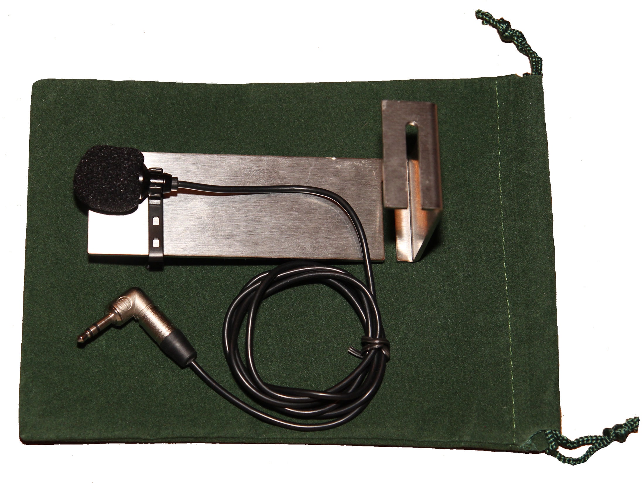

using this maybe?
what amazes me that I can get every piece of shooting equipment I own to work straight from the box, and during my working days I worked on everything from nuke reactors for the Navy to multi state telemetric systems but I was too dumb to get a high end chrono to function. Maybe the one I got was just a lemon, but the CS sure were not very helpful over my month of ownership to get things going.
Using no external rigger.

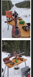

I was shooting with Tom Mousel one day and he is the one who gave me all the tips on properly setting up and using the radar. I haven’t had any issues from the very first shot using toms advice
Here is one of Tom’s rifles with a 34” barrel plus muzzle brake. Probably 36-37” total barrel length to end of the brake. This is how i set up my radar regardless if the barrel has a muzzle break or not. The difference between me and Tom is that I shoot from the prone position and have mine on a low profile tripod next to the rifle on the ground.
now that setup I like. The way the unit is mounted and clamped to the bench would make it a lot less sensitive to vibration and hard to knock over.
