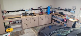

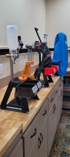

This will give you an idea on where I started. Still fine tuning. The light at the end of the tunnel is getting brighter though! BTW, I'm a sophomore at this.
