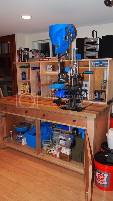

I have mine set up as an island. 2 progressive presses on each side, rock chucker and Bonanza press on one end and two RCBS lube sizers on the other end.
I highly suggest cleaning bench and reloading bench as a separate area.
I took a different approach. Since I don't use more than one press at any one time, they did not all need to be mounted. I do have a bunch of other tools that should be bench-mounted, but why waste all that bench space?
The bench below is 72" x 30". I prefer 30" because it allows storage of stuff along the back of the bench leaving 24" of open bench space. The mount system is the Quick Change System from Inline Fabrication and is rock-solid. The bench is shown with the RCBS Universal Case Prep Center on its custom made mount from IF. When a second tool is needed, I have a second mounting plate on a rolling cart to the far left.
It takes less than a minute to swap presses and/or tools. When the presses are not in use they are hung off the end of the bench. All the other tools have plates attached and can be stored anywhere.
