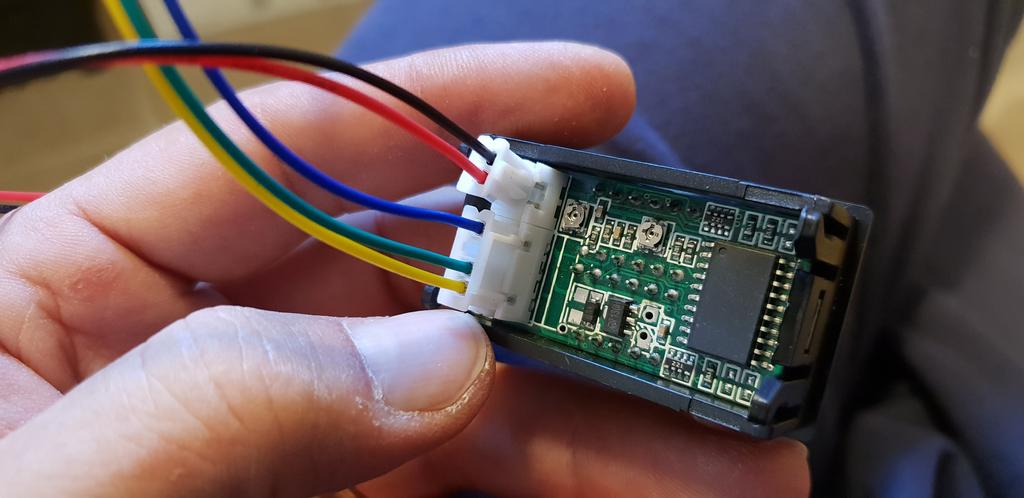

Need some help here for a builder. Any one seen this v/a type of meter? Screen name of builder is Sprin Go
Hi Regina,
Thank you for your previous answer, I got some thick wire and doing the wiring now.
According to somebody's wiring diagram from the forum, it says that the volt/amp meter has black, yellow and red wires.
Well, mine has blue, green and yellow.
As expected, I got no user's manual with it.
Can you please look at the photo below and try to figure out which wire is which?
Thanks a million in advance!
Dejan
