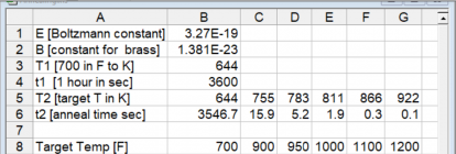

The following formula is used to calculate the time and temp to anneal brass:
B=1.38065x10^-23 (Boltzmann constant)
E=0.327x10^-18 (constant for the material, in this case brass)
T1 in Kelvin = 644 (700 F)
t1 in sec = 3600 (1hour)
T2 in Kelvin = target temp
t2 in sec = time to anneal
t2=t1*exp^(-E/B*(1/T1 - 1/T2))
This is easy to plug into Excel and if you pick 810.9 K (1000 F) for your target temp you will anneal in 1.88 seconds. Note that brass starts to glow between 950 F and 1050 F depending on the exact composition. Using 900 F changes the required time to 16.1 seconds.

FYI I've attached the Ambrell paper I have mentioned a few times here. They used 113kHz and 1250F. In the video relating to the paper (see below) they mentioned a time of 3 secs which of course includes the time it takes to get to 1250F. It is interesting to plug in 1250F into this guy's formula and see that the time required is de minimus, 3 hundredths of a second. Touch 1250F and you're done...

About the only defense of Reese's formula I've found is from this Ambrell case study. Plug in their target temp of 1250F from their PDF and you need only hit it for a tiny fraction of a second (which seems to be supported by their video).
Anyone working with a simpler GinaErik implementation would likely do well to use 1200F or even 1300F Tempilaq as their target. (Given the vagaries of deciphering color changes in Tempilaq 1200F or 1300F is likely accurate enough as attempting greater accuracy is likely spurious.) It also supports the idea that you want to deliver a great deal of power very quickly to the area of interest.

Check out the hardness vs temp for 30 minutes chart. Plug in the 900F point (where the curve begins to 'flatten') into Reese's formula as T1. Implies brass needs a lot of annealing if its been cold-worked...
Reese formula gives 16 minutes. It is not clear if Mr. Voort has taken pictures at 15-th or 20-th etc minutes to show the annealing progress. Most likely the sample is being already fully annealed in the half time. If this is the case the formula is on target.
Also see at 1200 F - 0.1 sec annealing time - actually Ambrell from your video indirectly confirms the formula.
From a practical point view - the time difference [~3 sec between 950 and 1000 F ] gives us ample opportunity to observe the tempilaq and determine anneal timing or to calibrate a flame sensor.
The formula is very complex and it reflects all the curves that Mr Reese has shown us. As you have said before, about the curves " it make sense", I believe the formula is correct and quite useful for our hobby.
Fill free to ask Mr Reese for his credentials (no need to say "Again, it's a shame he doesn't provide a little background on himself and his metallurgical skills.") or the origination of the formula. I admire the person who put this formula on paper,
