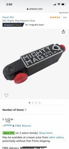

Handier than a pocket on a shirt. I also agree with dnellans the small noga is almost worthless, I bought one thinking smaller out of the way but I can move it around even with the magnet turned on. It’s not very sturdy at all...love the profile but it needs more holding power.
Ok I called MSC and they found the right one with the long stem.
Cheaper than Amazon and in stock and tax exempt.
