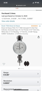

Indicating Barrels to chamber
I have pin gauges between the other 0.001" incretments to use as spud with my 0.0001" Intrepid test indicator. I use the spider on the left side of the headstock to steer the spud parallel to the spindle bore.

It's hard to beat a BesTesT from Brown & Sharpe, but their longest reach stock stylus is 1-7/16, but you can use an Interrapid 2-1/2 stylus if you re-thread to M1.4x0.3. The 0.00005 resolution drops to about 0.000125, but that's still much better than the Interrapid 312b.
ACtC-3fvLRJSaaeP8LXfjSp-J_RJH1_veXoOtbUOirdBKHy9qtFO5yqXU3TCVV-zumgoxgkIqa9LB1I9H6DU_Ismr47KdqDb0LbfrP3sTgG3BM5DmpScZ3buCDPaTcFD98gn7Q54KVtm-mFfJ9nO_VD9F7DzJQ=w1170-h877-no
ACtC-3fpUCRE0KONrCjLt4guYiA-ShihrQ250rTKt9gj74FohbC5Z_PyYeRUBoGmEw7CVwb9PSoWehmmM3CXjknYEj-LxWsXnWJaE-rDpwSZh5oLRc0WxBSWaebrgBO_4dW4aEd_bs_pB8Y60KELOzY4emY3OQ=w1186-h877-no
This is where things get funny. Take away the marks between the lines and it only a .0001" resolution. Put them back and its .00005". The indicator is no more accurate. And a .0001" indicator at 1/2" with a 2.5" long interapid stylus on it is no benefit. Until you use a real interapid and see the huge gaps between the delineations you don't know what your missing. I have mititoyo, starrett, brown & sharpe, best test, ext. I only use my interapids for dialing barrels.
My Brown & Sharpe Test indicator 599-7033-3 0.00005 has a 1½" dial face same my Interapid 312-15 .0005 2½" needle. I find the Brown & Sharpe harder to read and don't use much at all.
Chet
interapid 312B-15 long styles is the best for dialing barrels. I’m not as good as Alex wheeler but I’ve had the best results from dialing in as long as it will reach and the breach. Throats are cut square and even. It takes practice to learn how to use it but it’s direct reading off the bore/groove no stacked tolerances from bushings or range rods.
