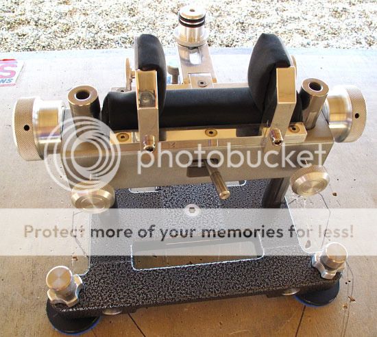

Up until the bylaw re-write, the front bag requirements were:
- Minimum 1/2" thick
- Minimum 1-1/2" wide
- Minimum 4" long
By those requirements, the "ear bags" on the 3-bag SEB were not legal, because they were not 4" long.
(how ever, that same SEB rest with a single bag was legal, as long as it had adequate containment clearance)
Here is the front sand bags 2012-B Revised and new Bylaws re-written, bags length requirements:
Before:
"Sand bags on front rests must be a minimum of one and one-half inches wide by four inches long"
Now:
"Sand bags on front rests must be a minimum of one and one half inches wide from the direction of the muzzle to the butt stock"
Now by the bylaw re-written bag specifications, there is no longer a minimum 4" length requirement (it up and vanished). There for the 3-bag SEB would also now be legal (it clearly never was up until this "bylaw re-write").
Donovan

To Ray: Wake up!!! This is 2016 already, your photo 'reference' above is taken/copied from Accurateshooter.com - that was when I made the prototype rests & bags last 2010 or 2011!
Please check out the production rests & front bags... attached a photo here for thickness/dimensions comparison... the top side plate is 15 mm (0.590") thick. Also notice the angle on the sides that contact the stock's fore-arm.
Now do your math and common sense!
*(Note: this is a 'special edition' unit, not the standard rest, but they have exactly the same bag shape & dimensions).
Either the one pc bag or the 3 pc bags, they already exceeded the minimum dimension requirements (Etc) if/when sand filled properly.

Hi Jeff,
Try to remove one of the side tension screws (or both), adjust the side tension to your liking, then align the rest-rifle-rear bag accordingly.
Just be sure that the side bags are at least or close to 1/2" thick over the side plate assembly. Adjust the sand inside, or (just) "push" them to be about 0.6" thick.
The CTC between the NEO posts is 200 mm, that gives 175 mm spacing (approx 6.89") between the posts....so with 4" stock + 2 x (0.5" side plate + 0.6" side bag) it will give you about 0.69" of free space.
If you use one side tension screw, and set it almost "half deep" (not deepest, say for fine/more tension adjustment), you still have about .35" free space/room there.
.35" side to side movement on the top will give you over than 38 MOA already.
That (4" stock) is about the maximum a NEO can handle, whilst the MAX can handle up to 8" stock.
Hope this help,
seb.

Seb, the only issue i see with your rest is that the side tension screws are too high in the side plate and push well above the 1/2" area of the fore arm. When tightened to get the proper side tension desired, it causes them to trap the fore end. Maybe a lower screw hole would help. jim
Does it really make a difference whether the bag is 4" long, or 14" long? Look at the NEO. When you place a 3" wide forearm on the bag and add the 1/2" thickness on each side (side bags) you have 4". If you have a 4" stock sitting there , you now have 5". The difference is the modern NEO rest. It's adjustable. The bottom portion of the bag is more than 4" long. The side bags meet the 1/2" rule. Clearly, to the naked eye, a 3" wide stock sitting on the bag that complies with the 1/2" side rule is at least 4" long. A ruler and calculator isn't necessary. Looking at the old rules, a single front bag is referenced. At no time does it state the bag has to be one piece. The NEO and MAX with the 3 piece configuration is a single bag made up of 3 pieces. It is, never less, a single bag that complies with the rules. There isn't another bag in front of it, nor behind it. The SEB rests offer the competitor the convenience to adjust the bag for different width stocks. No more… no less. I can tighten the side screws on any rest that I have, and trap the stock, but I don't. Why would anyone want to trap the stock anyway? You certainly don't gain an advantage by not allowing the rifle to recoil! What's next? The joy sticks? Do they offer an unfair advantage over the next guy because they allow that person to adjust elevation and windage faster and easier? Shouldn't we be advancing this sport and trying to gain, rather than lose members?
Reactions: seb
Just stating the obvious, everyone here knows the reason for the rule clarification isn't for the common bags used on more traditional rests.. The Seb rest I posted a picture of is why you have a clarification and why Seb revamped his bag.. Again, The pictured bag and rest is what I have seen at the range..
Ray
Ray I have to agree with you, the Seb bags a year or two ago were not legal. A friend had one and the side bags would ride up on the MBR. stock. But I also see Seb has improved on the bags. Thanks Seb. So yes the new ones are fine. I try not to pay attention to what everyone is using. But there were guys that pointed out to me different rests that they thought were pushing the rules. So if you see this you should challenge them buy going to someone one the rules committee.
