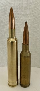

240 WM 95 VLD on left. It’s so cool.
6XC 105 VLD on right. Works as advertised .
