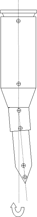

Mike - Thanks that would be great and yes they are the points. I drew both pictures (1 rotated through bullet point and case head like hornady and one around case body like V Block) in one of the other threads and will try and get them back up again. Indeed the points taken should be neck shoulder junction (or just on neck or just body behind shoulder) in Hornady as this is the point of max runout. On the V Block as close to Meplat as possible. I think the V Block should give a slightly higher reading but they should be the same order of magnitude.

I found the picture again. The diagram on left is exagerated runout and rotated around centre axis of shell like a V Block does. The diagram on right is same but rotated around a line between bullet tip and base (like hornady).
1) First thing you will notice is max runout is at bullet tip on V blocks but at neck shoulder junction on hornady or "lathe type". So to get the best (or highest in each case) reading on your runout it should be at point f on the V block and point c (or b) on the lathe type.
2) Next you will notice the "magnitude" of measured runout is less on the lathe type even though runout is the same. (distance from f to centreline on left is greater than c to centreline on right).
One of the issues with the lathe type is you cannot measure the "roundness" (as opposed to concentricity) of the bearing points. On a V block you can simply move the dial over the top of the V block as you pointed out Mike.
Now we have some new cross breed V/lathe combinations such as the H&H. Indeed they have moved the contact point further down the body of the shell and therefore would get away from the case head vs body runout issue but again the "roundness" should be checked at the V block. Also by moving the contact point further down the shell, the runout measurement is reduced again. Not that I see this as a big issue as it is still measurable it just must be taken into consideration when comparisons are made

Thanks Mike and understood - In this case I would recommend trying a reading on body just under shoulder for the lathe (point b on picture above for those looking on)- might be a higher reading than the bullet depending on bullet length vs body length. For the V block you are probably in the best spot to give you best indication.
