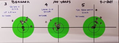

Here are groups 3,4 &5. First shot flyers are usually high or high left.
Edit: Group 3: First shot (left) was 1093 fps, remaining nine ran 1074 to 1087.
Group 4: First shot (left) was 1094 fps, remaining nine ran 1064 to 1084.
Group 5: First shot (high) was 1095 fps, and shot three was 1100 fps. remaining were 1080 to 1092
