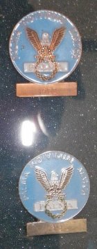

When I was shooting the Palma individual match there were two divisions-- Division "A" was the Palma Rifle and division "B" was Service Rifle. There was no shoot off, at least not in the SR division. It's been a while. I got the one in '93 with a score of 433, If I remember correctly. The thing that I was proudest of was that I was only two points behind Billy Atkins.
http://www.youtube.com/watch?v=dTn47KLQx0E
The bullet that I used was a 176 gr. Delta Bullet made by Rick Mulhern. It was a VLD and shot wonderful. Since he quit making them we all went to the 175 Sierra. I think that if I were doing it today, I'd try one of the long range Berger's in 168/175. The 22" barrel is too short for the 155 or 185 gr Berger's for that distance. I used my combat front sight that had been cut down to 3 clicks up for 100 yds. Most of the High Master shooters used a combat front sight because they were all older guys. ;)
It was about that time when The Marines were still shooting M14's that they won EVERYTHING in Army week. USAMU shooter Ken Gill was the first one to win the Service Rifle Championship with an M16. I saw him last year at the VA. He is in Fairbanks at Ft. Wainwright.
