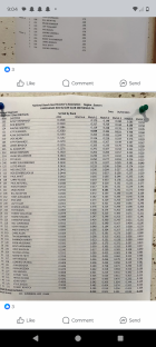

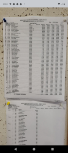

I believe about 5 5 shot groups were shot at 100 yards in the the 1's. I was taking about aggregate groups. Not a few individual targets.
2024 Super Shoot results. The best shooters in the USA.
Heavy Varmint Class 100 yards 5 shots 4 relays (aggregate)

If you look at the pictures I posted they were of 5-5 shot group aggs for Light varmint and heavy varmint with teen aggs
One having teen aggs all the way to third place

Here's a few that was shot today as well. Jeff's was a super small agg. So id say it can be done lol.
91 times is what i count for .1's or less in first day of that match
