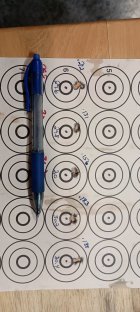

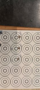

Guess I should have added in good readable conditions. Can you shoot sub one inch groups shooting in the .2's or .3's sure you can. But when the conditions get bad that extra tune will help. I usually shoot 3 shot groups and look for them to over lay. Not all barrels are created equally some barrels just won't do it. This is a day of tuning a good bra barrel at 100 yards using 3 shot groups then seating using 3 shot groups. It works for me. And yeah maybe the groups are off a couple thousands one way or another but you get the jest.

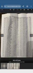

Only 8 out of 112 agg'd under 1 inch at 300M at Tack Driver 5.
Pretty elite company.....
I suspect those guns are capable of agging at or under .200 at 100 yards.
This is real time, tough changing conditions, under pressure with the cream of the crop.
What do you guys think the top ten were capable of under ideal conditions at 100/300? My guess: .1- .2/.5-.7.
