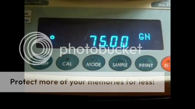

This is what it looks like at the worst if this video plays. Nothing moving in the room, the breeze shields on and the scale settings at the most stable. Just before and just after this it gained and dropped an additional division (74.98 and 75.04) but only once. When you remove the pan, the negative weight usually stays the same. The noise is a computer but not close and it does the same thing with it off anyway.

Sorry about the video, it doesn't play well online. To the right there is a download link. Download it and play it from your device. It's in an MP4 format and only 1,134 KB.

You have a surge protector...which absorbs electrical spikes to help prevent 'frying' your electronics. I am referring to a line conditioner which smooths the AC input (putting it simplistically). It is a fairly low end unit (Tripplite LC 1200 or 1800) but it works well.
T-shooter, try switching your scale to read in grams instead of grains.
What you're seeing - unstable over time when scale moves +/- 0.02 grains - may improve when you switch to grams.
Jlow knows his stuff when it comes to "performance vs. price" where scales are concerned. The Fx-120i's native mode is grams so the 0.02 fluctuations you're vexed by may be rounding errors showing up when the scale thinks something's changed but it can't display the change in a smaller unit when grains is the selection.
0.02 grains = 0.0012959 grams (0.001 is enough for our needs) & I've switched to using grams for weighing charges for this very reason. Variances of 0.002 grams won't affect your loads to any measurable degree.
