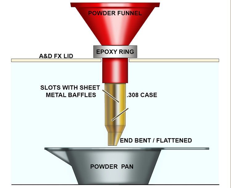

. . . I tried a powder funnel in the top but the powder fell through too fast and some bounced out of the pan. . . .
While your funnel, tube, and baffles may have solved the powder bounce problem, keep in mind that you can use a "pan" with much higher sidewalls. Paper and plastic cups come to mind first.
Here is a drawing of the funnel setup. I put a ring of epoxy to keep the funnel from moving. It's not glued to the lid.
