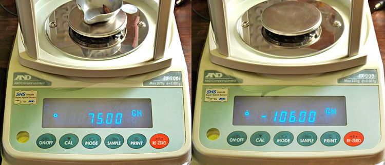

I made a small diameter weighing platform for this scale (on another post in this forum). It does help with minor air disturbances and is easier to use with the breeze guard open on 2 sides. 2.75" diameter vs 5.1" diameter. I use the Omega trickler too. Yes, a revelation from using the old style trickler and counting kernels.
So far today, it's been pretty stable. I think the trick may be to weigh the charge and if on the crossover point between 2 weights, add 1 kernel of powder and see if it stabilizes, and then remove it before filling the case. Also check every few weighings with a test weight. The other day it seemed to always fluctuate up, not down. If the number fluctuated and/or I lifted and replaced the pan for a second or third reading, the lower weight was the accurate one. I used a couple test weights to verify the scale was true. It would either settle on the exact weight or +.02GN. I still need to experiment more but maybe this thing will work after all.
Although it may not be related to your drifting issue, this was my observation. The weight of the pan I was using just happened to be exactly in between the counting increments of my A&D FX120. Being on that threshold meant that it could look like drifting when it actually wasn't.
I took a small shaving of aluminium off with a sharp pocket knife so it was close to the exact weight indicated and not in between counts. Not a drift issue per se but it made it a lot nicer to live with.

I had to reset the zero once because the negative weight when the powder pan was removed changed.
I suspect that part of the problem may be that your weighing process is inhibiting the balance's zero-tracking functionality from operating effectively.
These balances require functioning zero-tracking to prevent drift from accumulating over the course of a weighing/loading session. Typical 'throw-and-trickle' workflows can prevent the zero-tracking functionality from working. The balance needs to 'see' zero (or 'near' zero) for a short period, ideally every weighing cycle. If you zero the balance with the powder pan on the balance tray, and your workflow involves throwing a charge into the pan before you place it on the balance, it never sees zero, so zero-tracking is effectively disabled.

Now try the same, but with an object on the balance tray, so the reading is significantly non-zero. Make a note of the weight and see what it reads after an hour or so. You'll probably see a little drift appearing much sooner than that.
The solution for charge weighing is to zero the balance with the balance tray empty. Weigh your powder pan, then use the pan weight plus desired charge weight as your target. In this way, each time you remove the powder pan to dump the charge the balance sees zero which allows zero-tracking to function and drift is eliminated, even over long weighing sessions. This is the way my powder dispensers work, and they hold zero and retain accuracy over sessions of several hours. It even cancels out the effect of the odd kernel spilling onto the balance tray. I've compared the readings from two FX-120s on a 0.0001g analytical balance and they have always been as expected.
