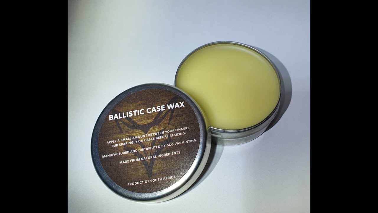

That’s it. I’m necking lake city 7.62 down to 6.5 creedmoor in a single pass in a Forster die and have had no sticking or collapse.
Buddy of mine produces this over here in SA, makes Redding and Hornady case wax feel like snot
