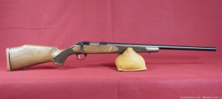

So finally I stumbled across a real jewel from decades past. A Sako Vixen, 6ppc single shot, heavy barrel, in a varmint style stock, L461 B prefix, three serial numbered action, with their very well respected externally adjustable target trigger. ------UNFIRED, IN THE ORIGINAL BOX---‐--

LOL, of course it will compete. Some consider that rifle one of the most accurate factory rifles ever made, accuracy varied from rifle to rifle but generally they are very accurate. I have a couple of Tikka Master sporters that will run with that Sako but most won’t. Finding one unfired with the original box is pretty cool, congrats on that. I have a few Sakos, one of my favorite rifle brands. I have a Sako 6PPC factory rifle and the same rifle in 22PPC, also a factory offering, these have sporter barrels and are repeaters, both shoot in the .3s, sometimes better if I do my part. There is a lot of threads on the rifle you found, search here and search the web. If yours has a hole in the trigger guard then you have the single shot model I like the most, you can adjust the trigger through that hole. You should share pic, they are neat rifles. I’ve seen quite a few for sale lately but that’s usually not the case.
