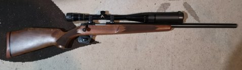

It was on a local gun action called ssl firearms… I did end up with it for 1060, with a 36x leupold br scope, match dies , Wilson case gauge , only down side is it has a cracked stock…
Depending on the size of the crack, repair shouldn't be the end of the world. You got a really good deal on the price. Now let's hope that you find the weight of the rifle acceptable~!

The wood is nicer and darker than the pictures he had. Then this morning, undressing it, bore scoping the six groove hammer forged barrel, it only got better after running some wet patches thru the barrel. Truly still in the cosmanine protectant from the factory. Then an absolutely gorgeous bore appeared.
Then after wiping down all the metal and lightly rehydrating the stock lightly cleaning it with some boild linseed oil, and dry rubbing it down. I am happy to say this is way better than my expectation!
So attaching the new bases and Pickatiney rail, I set the Burris signature rings up to accept the new 8-32X56 Sightron with an 1/8moa dot for my target needs. I decided it was time for some picks from archery targets.
Then in the man cave to do some chamber analysis. Things stil getting better, no problem reaching the rifling with the 64 grain Bib 790 jacket bullets I plan on shooting in it! So plan B will no problem as the 68 grain fb Denoffs with an even longer base to ogive will definitely work.
So now i have some 6ppc USA Norma brass loaded with 28.5, 28.7, and 28.9 grn of N-133 and getting ready to put some shots down range to bust its cherry, my first ever 35 year old Virgin! If that goes well and everything looks mild I'll work from there and take it to 29.2, a sweet spot for many of my 6ppc'

That 80's era of Sakos are the quintessential rifles for fine old school gunsmithing. A few years back I found the same as OP, new in box old stock, but in 223 with sporter barrel and sweet mini action.I actually wanted a ppc but nope. Field wood like his. Made a load and it shot ones holers all day long. Boring. I free floated it and re-finished to satin to get get rid of the 80's bowling ball finish. Trigger is as good any any jewel triggertech etc. Nothing to do to to improve! I dont shoot it anymore because I am into my 6br field gun long range. If anyone wants a classic non-plasitc fun coyote rifle can pm me. It is gathering dust in the safe.IMG_2281.jpegBallistic-X-Export-2022-04-09 13:05:36.878608.jpg

Very nice! Every one of those Sako 6PPCs I've worked with have responded well to that combo. They also respond to inline arbor press seaters if you're not using one. The Wilson 'OS' (over size) model is a perfect fit for the Sako chambers.

Yep Spike, it's the oil rubbed finish, with hand cut checkering, single shot, with the externally adjustable 2 stage target trigger, with the heavy contour Bofors hammer forged barrel, and these rifle barrels are free floated from the factory.
