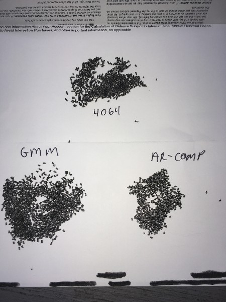

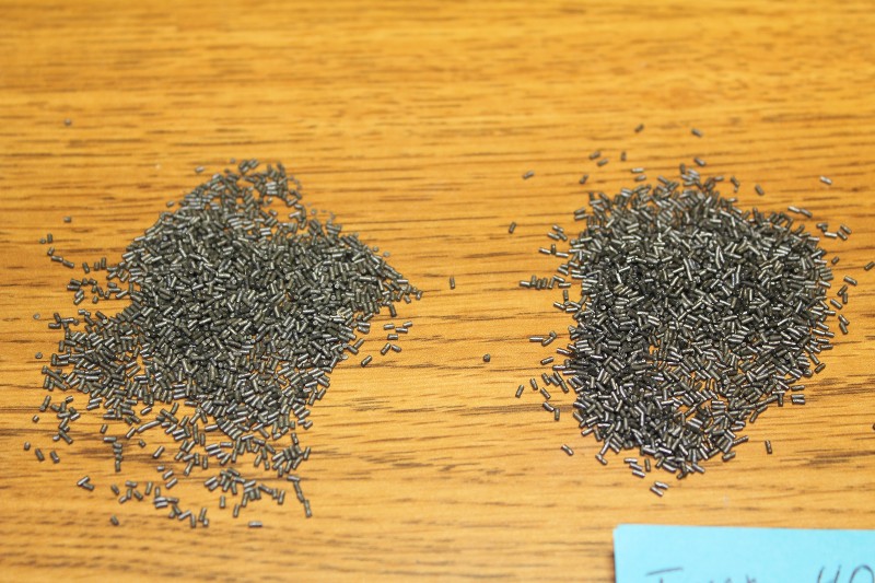

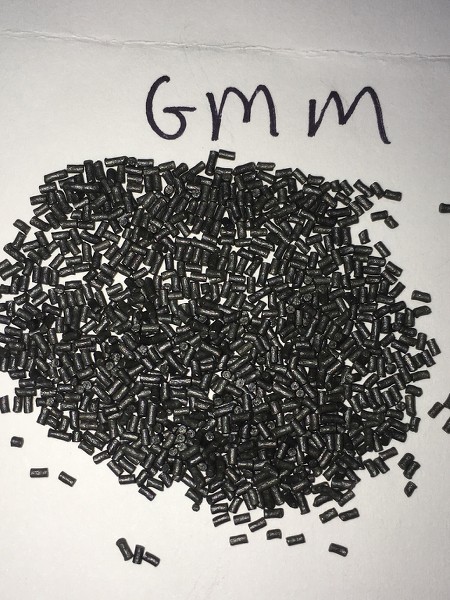

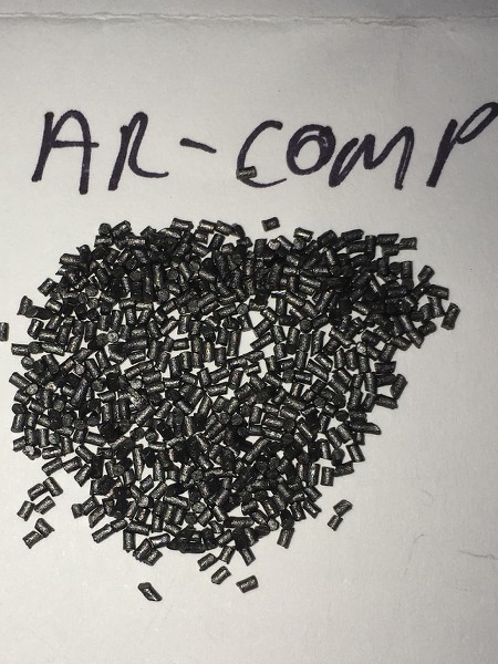

As a matter of fact I have some gold medal match 168 grain factory ammo on hand I will pull one of the bullets and we will compare him as a matter of fact I have some gold medal match 168 grain factory ammo on hand I will pull one of the bullets and we will compare the two powders ,I’ll post pictures .
Here is a photo I took 5 years ago comparing pulled GMM on left and IMR 4064 on right
Here are the photos I just took a moment ago after pulling a 168gr GMM round . This round was from a different/newer lot of factory ammo then the 2015 ammo .
I have to say the newest GMM does not seem to be the same powder as it was in 2015 , however the AR-comp appears to be on average a shorter cut as well but is IMHO a closer match now then 4064 because neither AR comp or the new GMM have any of the long sticks 4064 tends to have in it . Although my IMR-4064 is also over 5 years old , maybe as much as 8yrs old .
I'm now A LOT less sure of my self then I was .

Trust me. Modern Federal Match is AR Comp.
Maybe ill give em another try. I bet ar comp in there will work lots better
I have to say that this has really took me for a loop . I can’t imagine why federal would change what could only be described as a perfect combination to something different . It would explain why federal gold medal match does not shoot as well in two of my firearms that it shot amazingly in just a few years ago . I thought it was throat erosion or some other anomalies that was my fault but now if they change the formula. That would explain a lot , I mean a lot a lot .
