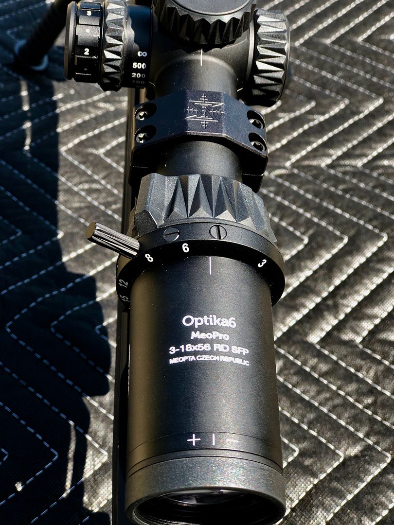

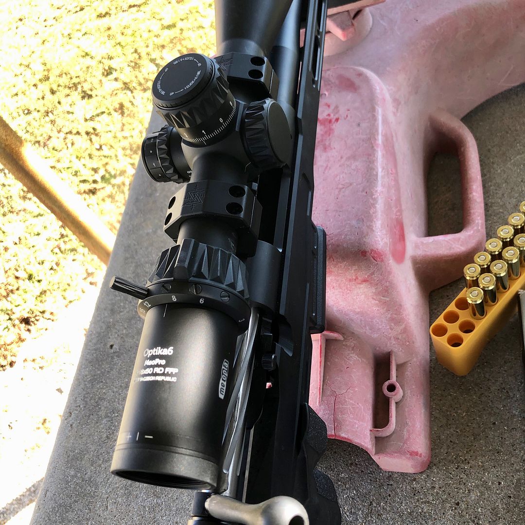

Dud, What do you think of your Optika6 scope? Like you said, lots of Up with internals and some great features. I do agree that a 20 MOA base will be a nice addition.
I think Meopta's failure to deliver the scope that I ordered sucks.
I wanted to be an early adopter, now I'm waiting and I guarantee I'm not going to pay MSRP if I order again.
Dud, I get it, I have heard that story from so many folks who loved what they say at SHOT Show and the early reviews. I suggest making a phone call to whoever you are going to order from and tell them your situation. I suspect that they will help you out. If you are LE/Mil Meopta has a discount program as a thank you. I was out sighting in my 3-18x50 FFP MRAD yesterday. The zero stop took all of 20 seconds to set. Man is it nice. Locked down with Seekins Precision rings and the Bergara .308 is a tack driver.
I ordered what I wanted, a 5-30x56 Dichro MRAD.
Evidently Meopta cancelled that model so I cancelled my order.
If they want my money, just deliver what they announced and what I ordered.
Until then, I'm not happy and I'm not going to pretend to be. Meopta dropped the ball big time.
