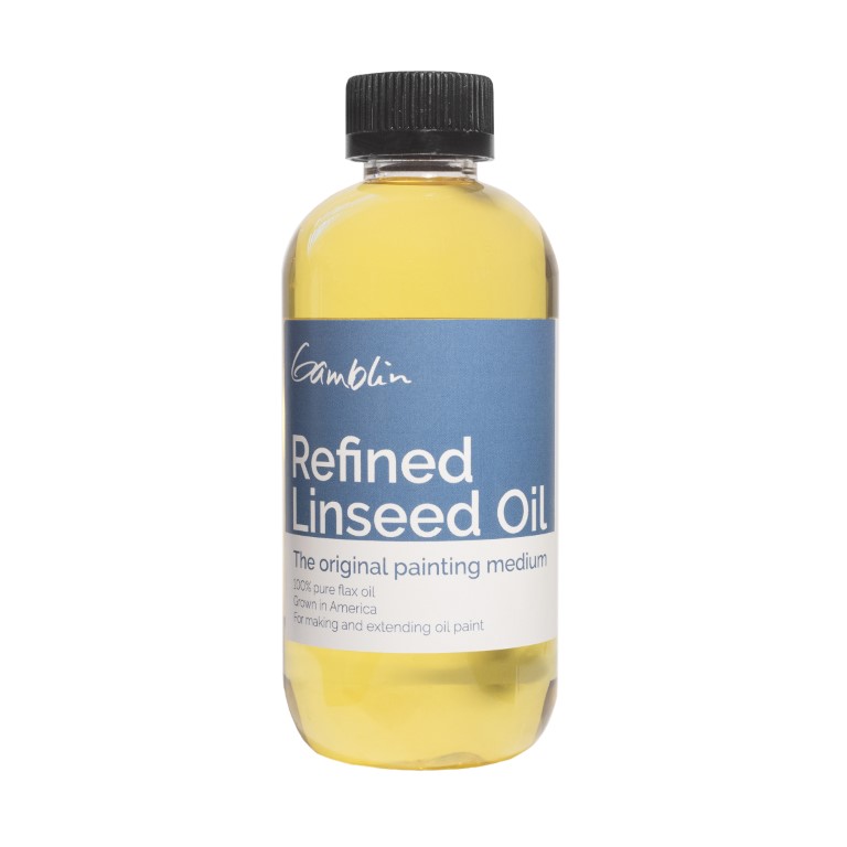

One question that I don’t believe has been answered is what are people using to finish now that Arrow oil has been discontinued? Is there a 2nd best option?

On mine, I’m using refined linseed oil. I would have used Arrow wood oil… I considered Tru oil. I looked at Lin Speed oil. But having used linseed oil on various projects through the years I went that route. Between the two, I chose the refined version over the boiled version of linseed oil.
Hobby lobby stores carry it in the paint section.
Right now I’m going to just use that. I may or may not add a hard finish. Or a wax finish. Still researching some of that.
I’m in the process of hand rubbing at this point after two polishing of 1500 grit; one with oil and one dry.
