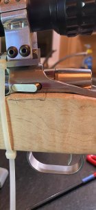

I’ll be milling the pillar a wee bit to fix this little blunder.
I always leave that particular area of a stock about a 1/4" proud, from the grip to a couple inches forward of the trigger guard. After inletting the guard, and checking the final fit of the whole works I will remove the extra wood.
I found I can measure all I want, but sometimes things happen, and the little bit of extra wood just in that area is nice to have on occasion, and can be removed quickly for a perfect fit.
Jim
It’s time to get the files going !

What ya got in mind taking off or reshaping??
Reshaping just a tad bit.
I started with a rasp then went to 100 grit followed by 150 just to get close. I think it’s better already.
It would help if I knew what I was doing . :cool:

Maybe bed the low spot under/behind the rear screw hole ?
That might work, too. I hate to admit it, but I’ve scabbed pieces on to cover “issues”. One of my worst was changing a Remington clone stock into a Kodiak stock. I’ll look for a pic.
Found it. Even the dog had her doubts! Extra wood behind the action and the trigger guard. Oh…and the bolt notch.
The dog definitely had doubts’ I have to put the action back in to check the clearance, it wasn’t all the way down when this pic was taken.
Use a little heat to get the sleeve out, I’m sure it’s got some epoxy on it- all else fails saw the butt off where you want it- up to the sleeve-
On the trigger guard, make sure the trigger doesn’t hit the bottom of the guard, before milling it off- or YOU will be adding a piece to build it back up-
I’m actually liking the bedding approach rather than milling.
