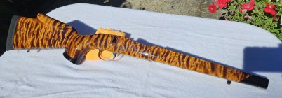

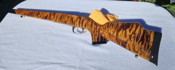

Love the tiger wood effect. I am in favor of inhancing the grain as @Bc'z is showing. This looks amazing it really makes the wood natural beauty pop. Almost too good to take out and use.
Yup. We post pics of our best work, then he drops a pic of his magic talent and ours look like dog turds. I would really like to grumble at him but his work is just too good. I bow to a master.
Get black, medium brown, vintage amber, those are 3 go to colors.
Black and medium brown make dark brown. If you add red or orange to medium brown you get different shades of copper.

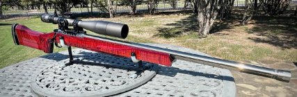

I worked light to dark on this project for @Rank Amateur, torified maple vintage amber, red, burgundy were only colors used. Dyes were used straight no sanding between coats.IMG953087..jpgIMG953088..jpg
