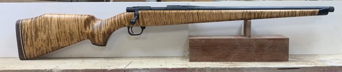

Using Maple, with a bit of figure in it. My test board with 320 grit and five coats of refined Linseed oil. Hard to see, but the far end is more matte, the near end above the pencil mark I hit with 1500 grit. That brought out a bit of shine and smoothed it up. I’ll probably do more oil coats on the test board until after I finish the stock work.

I think starting with basically a board, and mostly handwork with chisels and files, and a dremel carver for the recesses, there will be 80-100 hours in it, more towards the high side. I’ve yet to bed, finish, and address the recoil pad.
I had a nice channel in the comb for the bottom of the bolt. However, I cut a hair deep with a chisel and couldn’t work it out with sanding. Still got to figure out how I want that transition to look.
The basic inlet went somewhat fast, the gradual final inlet went slow. I didn’t have any inletting ink, and basically took my time finding interference and addressing it. The barreled receiver was fit, then the bolt release attached was fit, then the trigger attached, then the bolt handle recess. The bottom metal wasn’t too bad, but it was a meet in the middle affair between it and the action. I inlet until I had what I needed from top and bottom.
The palm swell and off side grip took a bit. I’ve reworked the palm swell more as I go along to fit myself. I’m a hair back from ideal, but in dry firing, it’s pretty smooth. The trigger breaks with no bobble. My trigger finger is more towards the tip on the shoe than the pad.
The front forearm will be mostly square ish. There’s a very slight taper on both sides and a more pronounced taper on the bottom near the end. It’s a 16.25” barrel, so the whole forearm is a bit shorter to get some proportion. I believe it will be a more robust looking stock rather that I refined looking stock.
I wanted a wood recoil pad, but no black ebony was available locally, I had a piece of teak on hand I’ll use. I’m allowing for the possibility of changing out to a grind to fit pad if needed. The stock is currently 15” ish or so in LOP. I’m going for 13 1/2” when I start on that next.
I found myself needing tools that I didn’t have and couldn’t find to do a couple of things. I repurposed a thing or two, and turned a piece of brass to make a spacer for a marker. Had two long 6mm bolts I used as position bolts. The Iwasaki files are a significant time saver. Would like to have another one or two, but they are hard to find in stock. A clamping system might be nice, but overall, I’ve been working off of a shooting rest under the forearm and a shot filled squeeze bag under the butt. When I need rigidity I clamp the forearm to my work table. I’m about to need to work vertically, but I think I’ve got clamps that will work out.
Overall a good learning experience. I’d recommend it to anyone. A free style stock lets you back up and regroup if you need to. I’m just trying not to screw up. :)

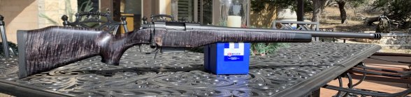

Take a look at Woodcraft. It’s where I get my “good” tools and smaller pieces of ebony and other woods. They have some nice gouging chisels and the Japanese files. A good source for Analine dies for that gorgeous Tiger maple you’re carving up. Here’s a couple I did in brown and black:
