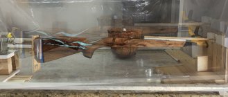

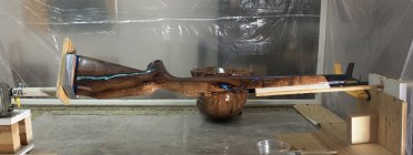

Do you have to buff any on the epoxy ?
The first coat had a few air bubbles and a couple missed spots around the bolt notch. I did a lite sand with 320 and put on the second coat. I’m still working on this technique. The first one I did, I mopped on a heavy coat of epoxy with the motor set at a higher speed. It worked well and I got a thick, even coat but I had some air bubbles trapped deep. On this one, with a thin first coat, the bubbles are easy to sand out. The second coat is almost perfect, with the high gloss, smooth surface. I found one small hair on the finish that got thru the tent. It’s so minor, I’m not going to worry about it. It is supposed to be a tough truck gun, after all.

I used to avoid gloss finishes. You've got me rethinking that.
That looks really nice ! Was that mesquite ? When you set the turquoise in it did you use regular epoxy ? You did good!
Yes. Mesquite.I mixed up some thickened “peanut butter” consistency epoxy and pushed it into the crack to support the stones I placed. When that hardened, I made up some mayonnaise with turquoise dust and filled around the stones, thereby sealing the crack on that side. I flipped it over after it hardened and poured epoxy into the crack until it was 1/4” below the surface. I placed more stones in the crack and filled around them with turquoise dust thickened epoxy. Flip back a few pages for picks of the process.
If you try the epoxy finish, you have to round all the edges. It pulls away from sharp edges.
I like it a lot !!! Looks like it’s 3/4” thick
I want to do the epoxy fill… I may on my next scratch build.i got 2 slabs ready for a bandsaw to shape out , just got to find time to do it all.
