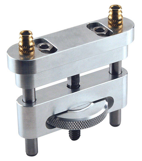

Who makes the best cheek riser hardware?
I need something that goes pretty high. Might be a matter of making my own pins once I get the clamp part.
