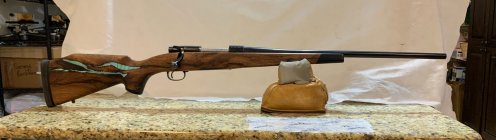

6 coats is good for 1 session, I'd sand and clear it a few more times.
Durability will never be as good as a 2k urethane automotive clear.
FWIW I have had very nice results with HOK high solids 2 pt urethathane out of a small Badger touch up gun. Usually on a gelcoat BR stock with their tint additive to knock down the two tone gelcoat appearance.
Couple coats and then overthinned with final to allow it to really flow out and keep weight down for 10 1/2 lb guns. They come out pretty good.
Use a lot of various 2k urethane stuff but mostly high end model stuff out of airbrush.
FWIW I have had very nice results with HOC high solids 2 pt urethathane out of a small Badger touch up gun. Usually on a gelcoat BR stock with their tint additive to knock down the two tone gelcoat appearance.
I spray a bunch of HOK, just haven't tried thier clears as I have a few different clears I use regularly.
Aaron is doing a wood stock its gonna take multiple coats with multiple sessions to achieve a pore free glass like finish
I had a good long talk with my friend during the 2 hour drive to a gun shop in Hondo. Thru serepticious questioning , I found out he HATES glossy guns for hunting, so I sanded the stock with some 3000 grit to knock off the shine. Sorry Gabe.:confused:

Now,now. The whole point of this exercise was to make the guy a gun that he’ll use. What ever we think is beside the point. The good news is that I was able to sand out that hair in the finish. It was driving me nuts!;)

No. The stock is a surprise Christmas present, along with the metal that goes into it. I’ve been sneaky about finding out what he likes during our conversations. I had his wife and daughter in on it for months. He’s a new Texas friend I met when I arrived. He’s big into guns, shooting and he runs a hunting ranch. He had his truck broken into and lost his truck gun. This gun build is to replace the gun he lost.
When doing the epoxy finish, it naturally turns out super hi gloss. Dulling it up only took an hour. I put it together this morning and my wife put a bow on it. He gets it tomorrow night. We’re going to dinner at his daughter’s house.
