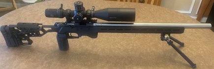

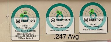

My DPG rifle was one of the first out of Kenny's shop that has the CZ action and barrel threaded versus his original slip fit configuration. Regardless of his methods for his builds. Action speaks louder than words. Below are target pics shot while tuning with an ATS tuner and SK Rifle Match. No cherry picking here. Just the three best settings. Ive had similar results with SK Rifle Match, Lapua Long Range as well as Eley Team and Eley Match. Rifle pic was before tuner installation.
