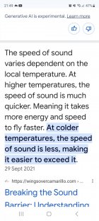

Maybe the temperature has dropped so has the speed of sound but the 22lr ammo is still running near its intended speed which takes its through the sound barrier.
In warmer temps the sound barrier is greater and the 22lr ammo isn't reaching the velocities break the sound barrier to cause muzzle cracks..
Reactions: MUP
You can say what you want about ai but goggle has been here a long time. I've spent the better part of the last 2 days looking for information and haven't come close yet. So much for ai.
