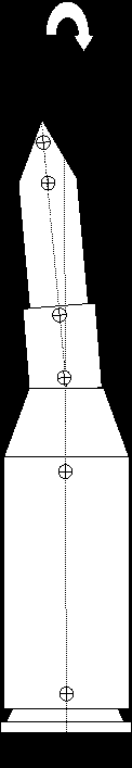

Your getting closer! It does measuring from the diameter, but it chooses the datums differently to mitigate some of the form errors on the brass. It tries to do so by taking two datums on the bullet (a swagged component which is far more accurate) and only one datum on the cartridge brass. The H&H gauge does the same, so did the 60's LE Wilson case spinner. They are all still a TIR measurement but they selected their datums differently to mitigate some of the brass form errors.
Most of the form and concentricity errors on our brass comes from off the shelf sizing dies that are heat treated after being reamed. This process just causes way too much variation of the die.
Actually you can have perfect concentricity in a part that is oval shape but it will show this form error in a TIR inspection. TIR for the most part equals concentricity plus form error (in most cases). Here let me find that youtube GD&T video on concentricity. It is just hard to understand the differences without seeing it.
OK stiles, is this runout or lack of concentricity?
What if the bullet tip where shifted to the right to reach the C/L and the neck was still at it's indicated angle?
Application of machine parts and that language to bullet concentricity is really a mute point, while they may indeed be subject to the same terminology as applied in the lab they are different applications.
