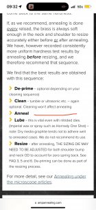

Amp just confirmed:
Thanks for your email. Cleaning makes no difference to annealing either way. We do find that brushing inside the necks after annealing does assist with more consistent bullet seating pressures.
