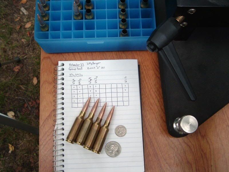

Cleaned with the SS pins and annealed on the benchsource.
I use the very same process every time I reload them.
Never seem to notice , 'stickiness'.
Bullets are coated with HBN though.
HBN is your friend.
