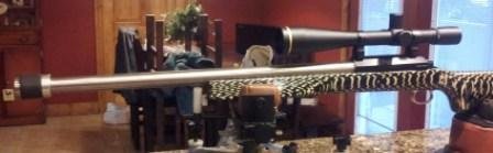

Buckys tuner installed. chambered in 220 beggs as well as a 6ppc barrel threaded for this tuner

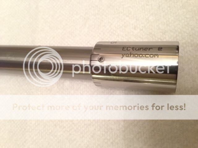

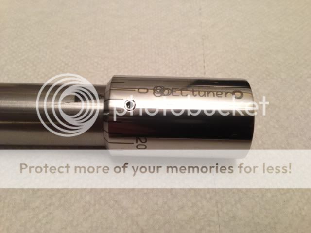

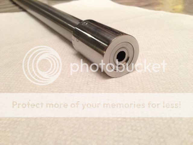

Just finished installing a tuner on Monte Milanuk's barrel. This is what it looks like on a barrel that is .900" at the muzzle.
The arrow on the barrel is a reference reference mark to keep track of the tuners adjustments. The mark is on the left side of the gun so that the shooter can simply move up and stretch his arm out and move tuner if he needs to.
