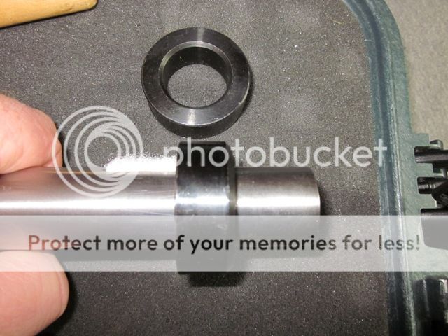

Erik thanks for the pic. So you lock in the tuner setting with the screw in your last photo?
No, the tuner is not locked, the screws provide friction so the tuner does not move on its own, but you can turn it by hand if you need to.
The tighter the screw, the more friction they provide.
Erik Cortina said:
Just finished installing a tuner on Monte Milanuk's barrel. This is what it looks like on a barrel that is .900" at the muzzle.
The arrow on the barrel is a reference reference mark to keep track of the tuners adjustments. The mark is on the left side of the gun so that the shooter can simply move up and stretch his arm out and move tuner if he needs to.
Erik
