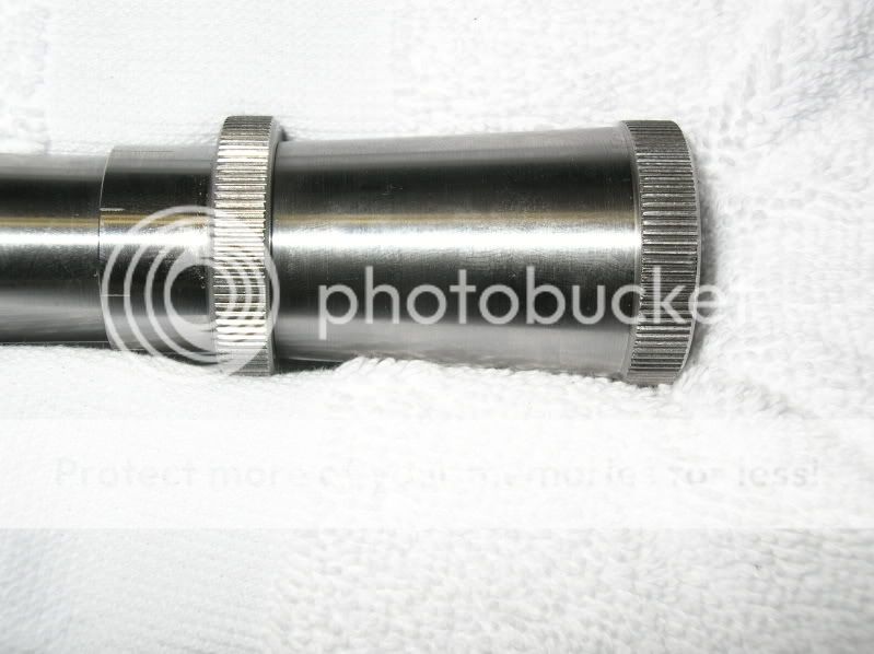

These photos are of Darrel's rifle at the 2007 World BR Championships in Austria. I cant say is this is the style he is still using, since I haven't seen his rifle since then. I had a close look at the match, and the tuner appeared to be a Schmidt/Buckys design.

Threads onto the barrel. Jam nut setup. Easy to adjust if necessary. No tools needed. No nylon screws to fool with. KISS. It works!!!
You don't have to fool with nylon screws on my tuner either. And mine does not have a jam nut setup, just grab it, turn it, and it will stay put, it only takes one hand.
