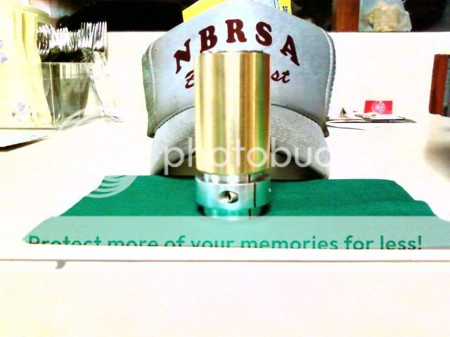

Here's a picture of a Jackie Schmidt tuner fabricated with aluminun and a marine prop shaft bearing made with brass and rubber.
This is the tuner that was on Jackies HV 30BR rig when he almost set a new HV agg record a few years back in Midland,Texas...
it weighs approx 5oz....
