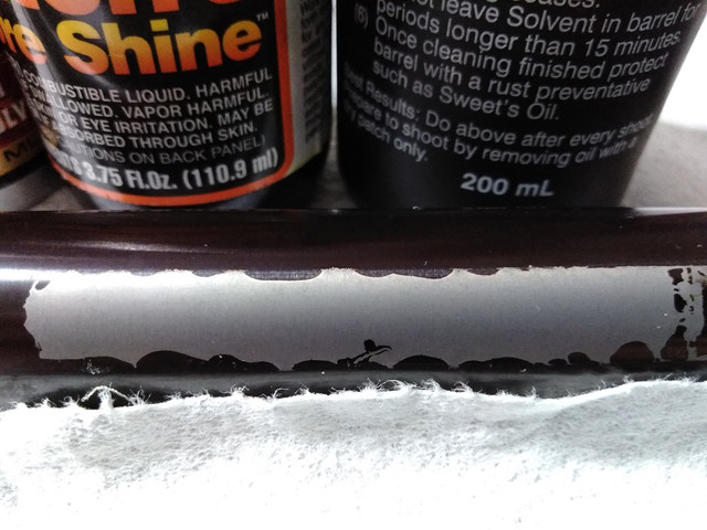

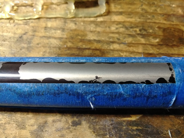

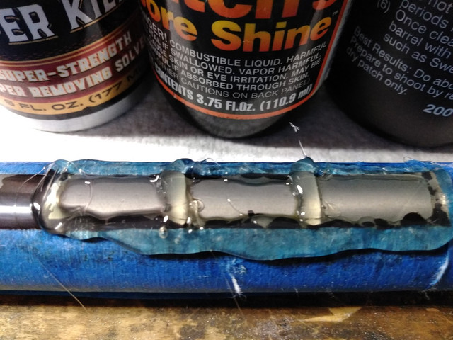

Carbon removal test. Barrel Damage Test.
Alright, should I even try it on the SS barrel? After seeing these results, I honestly don't see it causing any "noticeable" damage? But, on the other hand, I wouldn't be trying this if I didn't want to know for myself.
CLR is what I am REALLY interested in. If it can remove the carbon from the barrel as well as it did from the 300 BLK case, I am game!!

Unfortunately, the type of test you are doing is most likely to reveal only very rapidly-occuring and obvious damage to the steel. It is far more difficult to determine what the effect of repeated short exposures over a long period of time (i.e. routine cleaning) will be.
