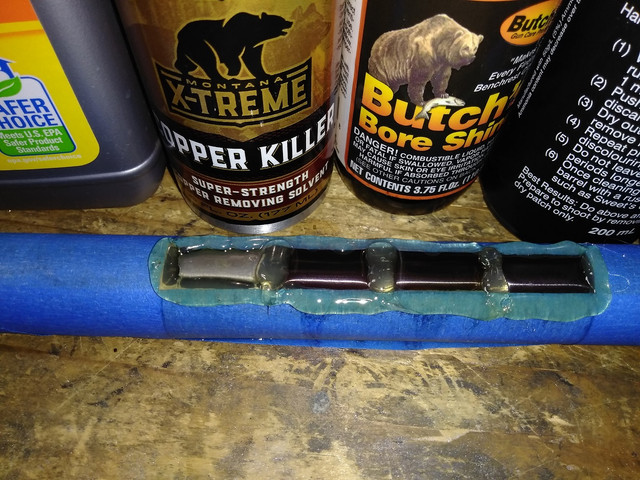

I think I will do a barrel test tomorrow. Put these cleaners on the outside and let them sit for an hour and see what happens. Stainless and chrome moly.

I'll just try the ones with the warnings on them, plus the CLR. I am sure that Hoppe's and Wipeout won't hurt a thing. I used hot glue to make the dividers.
Why do that to a good barrel , CLR & Sweets for sure will harm the steel if left on too long , maybe all of them will . Water for that matter will screw up steel . With any type of cleaning caution and common sense . Next test is how to repair the problem marks that chemicals make.
One hour in and not much more seems to have happened. The Sweets seem to have dried up.
I like learning. I don't think it is going to do a bit of damage that will keep the barrel from shooting.
This is the best picture I think I could get of the "after damage". Everything but the CLR looks perfect to me. I will now CLR the entire section, and redo the three cleaners on bare steel.
Why didn't someone tell me to shut the flash off? A lot better pictures.
Used CLR to clean the barrel of bluing for the next test.
