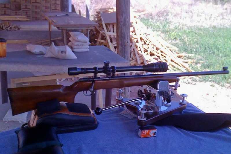

Steve, Eley Club (Orange Box) is very, very good for the price and given your parameters, may suprise you how accurate your rifle really is!
50 yard, 5-shot groups. Shot from a Remington 513-T, NOT a match rifle by the stretch of anyones imagination! Scope is a Weaver T-25 25X
https://www.goodshootinginc.com/index.php?productID=672
WOW!!
I'll definitely give that a try
Thanks,
Steve

Steve I dint want to crash your thread but a PM to ultra mag 44 hasn't been responded too. I wanted to ask if ultra mag 44 would tell me how the scope was mounted to his 513T? I have one and haven't made up my mine if I will use weaver mounts or buy a strip of 3/8s dovetail material. his looks to be weaver mounts but is hard to tell, I had thought they would look bulky on a 22 but his however it is mounted looks good. thanks
