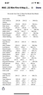

JSH has a good point--I agree but....Our MTR Cz's get hold of a fantastic lot of ammo and they score up there with the big dogs sometimes--we have had several matches recently where Factory CZ's were scoring up there with top of the Vintage class-- 500's with 30+ X count in 50 yd bench match
I agree with your main point but Killer lots of ammo can make a good shooter look great and prove just how good the rifle really can be--I guess that is the goal --get all we can out of whatever we are shooting
When I look at the Race rifles scoring 500 with 45x and then look at our class winner with a factory CZ MTR shooting 500 with 34x I smile ( and dream of doing it too)
