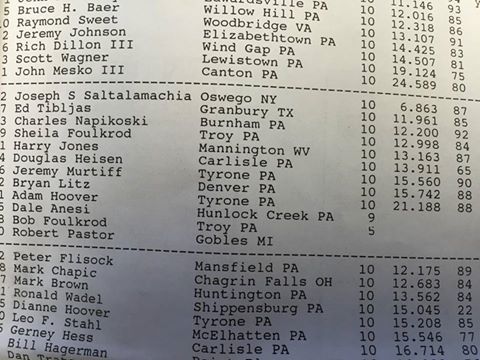

If it's all that common of an occurrence, then by all means at least one of the shooters should invite Bryan Litz out to a match. Then they could demonstrate it to him firsthand, since he's been asking for anyone to do that for some time now. Seems rather odd no one has taken him up on his request as yet.
He has been invited multiple times
Ray

gstaylorg the last time Brian Litz was in williamsport was 16 years ago He was in both my relays and he didn't make out so well! I've shot against the best shooters in the world, sometimes they win sometimes I win. I managed to get Sebastian Lambang of Seb Rests to come to this years World Open. Lucky I guess. Brian is only in Michigan not half way around the world. He knows the way he shoots at Reade range in PA. But he shoots different discipline, 1000 Yard Benchrest is to easy.
Joe Salt
